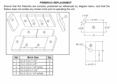

I think a diagram would help. I grabbed this from my manual.
I am trying to do the same thing and have been thinking the hammer drill route.
I've attached the diagram from the Isle Royale which is what I am using and working
over replacing the firebricks since like others I'm not too happy with the low density
brick used by Quadrafire.
The two 1.5 inch holes are needed for the rear air intakes, shown as brick 5 in the diagram.

OK that makes more sense now that you've given us a picture. The brick yard may be able to drill the bricks for you, as mentioned - if they can, it probably would be the lowest hassle approach. I still don't think a dremel would do it, and seriously doubt that a roto-zip could either. A hammer drill w/ a small bit might work, or you might be able to use one of those masonry sabersaw bits that I mentioned earlier.
