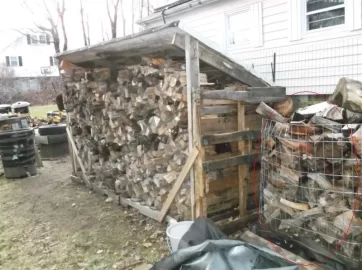

Depending on how much you have and what kind of wood it is..........the 8"-11" long pieces wood be in my fire pit stack or my BBQ pit stack (cherry or hickory) the 12"+ long splits, stack them on top of a wood pile that has longer splits.....or take your chicken wire / hog wire and wrap it around 3 or 4 posts you drive into the ground a few times (around a pallet(s) or large rocks for a base) and toss them in.
Take a pallet,build a bin, take your wood and throw it in.

i stack my shorts in with regular splits. if they are 8-10" i can double them length wise and make one 16-20", which is usually what i cut. sometimes with limb wood mixed in the pile i can match up a funny crotch of limb to a short split. its kinda like playing Tetris and usually works out if you take some time.
or you could always noodle the large rounds, cutting length wise and keep the length. something to try in the future.

If you have that many start a separate stack, just don't go so high.
bob
I make round holz hausen stacks, and the short pieces go in the middle. Short pieces are nice because they will go in the stove "north/south" with one end of the piece facing the stove door. north south is a great way to load the stove, and if short pieces weren't more difficult to handle, I'd cut all my firewood short.
