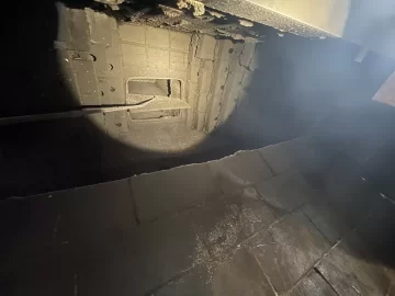

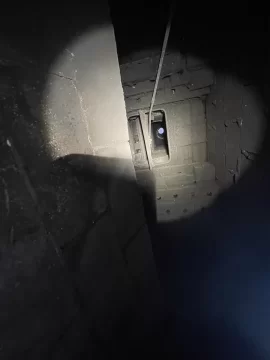

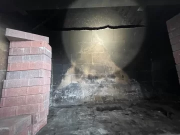

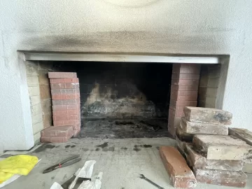

I took a few more photos to help clarify:
I'm thinking I'll raise the grate with some bricks, and make a smoke guard with a piece of 3-4" wide steel up top to see if that helps. The soot on the fireplace is from my aluminum foil experiment (that did seem to work).

You really need properly sized flues for your fireplaces. That looks like a pretty large firebox i really don't ever see it working with that small flue

The clay tile before the silly metal chimney top looks like maybe 10" x 12"? If so, using the 10 to 1 ratio, that would support a 1200 sq. in. fireplace opening, or 30" x 40".
The 8" round flue is about 50 sq. in. in area, times 10 = 500 sq in or about a 20" x 25" fireplace opening.
