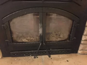

on my left door, there is a greyish color that doesn't come off. i'm not sure if it was scrubbed too hard at some point, or water got on it, or something else. but, it doesn't go back to black.
do i clean with a rag, then oil it? or, spray with high temp paint? something else?
do i clean with a rag, then oil it? or, spray with high temp paint? something else?View attachment 253198
Paint it
Yes, looks like the door overheated in that spot and fried the paint. Repainting is the only solution.
Use stove paint, not rustoleum high heat or whatever.
If you want to touch it up, I'd contact the stove manufacturer and ask for the manufacturer and color of paint to use for a touch up.
You could also just repaint the whole thing with Stove Bright and you won't have to worry about matching colors.
I’m pretty sure it’s metallic black. Doesn’t really matter, after a stove has been that hot the paint never matches well. Mask everything off and repaint the face, you’ll be glad you did.

You will at minimum have to repaint both doors.

I think I would brush paint the doors in this circumstance.
