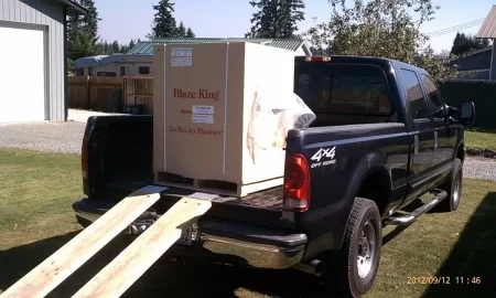

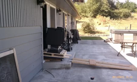

I installed my PH about a month ago. First,I used ramps to get it off of a Ford Ranger pickup......used 2 , 2×8 's.... got the pressure treated wood cause its stronger ....make sure you do that......the ramp kit I bought from Lowes for only $20
.. they have it in stock at the store.........the 2×8's were six feet long that I used.......depending on how high up your trailer bed is , you don't want the ramps too long because it will bow the wood down a lot from the weight of the stove............ kind of rock the stove back and forth, walking it to the edge of the trailer bed and onto the ramps, making sure that the ramps are staying secure at the same time, to the trailer bed....
......once the stove is on the ramps it just about takes one person guiding it ,slides down pretty easy to the ground.

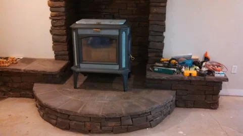

Got it in. We used an appliance dolley and five guys. Ramped it off trailer. Rampled it onto the hearth, laying down boards to distribute the weight under the ramp ends. I fired it up for the first time last night. We were blessed with a late cold front. It was about 31 degrees at my house. I only built a medium sized fire but I am already impressed with the heat and efficiency. 40 minutes into my burn and I could already tell I was getting a lot more heat for the amount of wood used. My old smoke dragon must have been losing a bunch out the chimney. Another thing I noticed is how fast the stove, including the stone, heated up. Everyone says that a negative of Soapstone is the slow heat-up time. Personally, I think that concern is way over blown.....a non-issue. Thus far, I am very pleased. Beautiful stove, beautiful fire, puts out the heat. I realize I have only burned in it once, but if that experience is a fore-shadowing of things to come.....I will really like this stove. Stove was still quite warm in the morning even though my small splits were nearly coals before I went to bed. (I didn't have any wood left at my place....burned it all up in the smoke dragon.....but have more seasoned wood at my Dad's place for next season)
