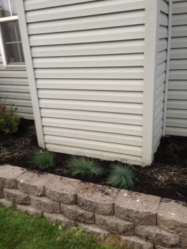

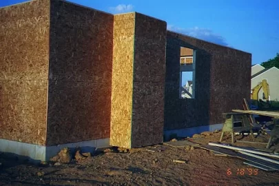

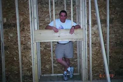

Check out these pictures... I'm really starting to think the floor beneath the stove is probably rotted out..

Even if the floor is not rotted out, the pipe going up through it is open at the top (duh). That allows cold air to get in the pipe.
I presume the pipe is not insulated (as I think it never is for pellet exhaust? - I have no pellet experience).
That means you have outside cold air in a thin walled metal pipe. That cold is going to go through that pipe and will cool the air in the chase.
That air then (without a block-off plate) will sink down and run out around the insert. That will feel like a draft. (And warm air will go up the chase to replace it).
I think that if you add a sealed block off plate, your problem will be gone.
