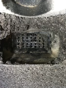

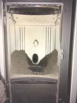

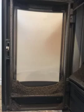

The following is the way I have set my stove, by the way it's a P962 witch is an older version of the P963
line 06p - stands for P1 pellet feed rate = 1,5 seconds ( not all version of firmware will allow you to go that low, go as low as you can. )
line 07p - stands for P2 pellet feed rate = 2,7 seconds
line 08p - stands for P3 pellet feed rate = 3,7 seconds
line 09p - stands for P4 pellet feed rate = 4,7 seconds
line 10p - stands for P5 pellet feed rate = 5,4 seconds
My stove run like.... just wow ! here are some picture after burning 200 pound of pellets. You can see there is no soot on the glass, no ash in the grate and I have a tremendous amount of ash in the ash pan.
View attachment 196076 View attachment 196077 View attachment 196078

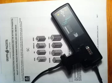

Well for you guys out there that want to make change and are stuck with the default setting. There is a tool called boot loader you absolutely need this and the correct firmware. I am not authorized to send or share any of these files. you have to ask your local dealer to come and change your Firmware. once you will have the correct firmware you will be capable to reduce the pellet feeding rate lower then the default settings. If your dealer does not know what you are talking about give him my email. [email protected]
[Hearth.com] How to reduce heat output(KW) on a Piazzetta
