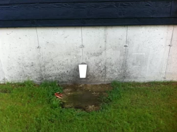

  • Figure 1 Mont Vernon on this picture the chimney installation is a little too low, but it was only to show you the soot cause by a lack of air, this wall has been cleaned with a pressure washer and still shows trace of soot from a none adjustable stove.

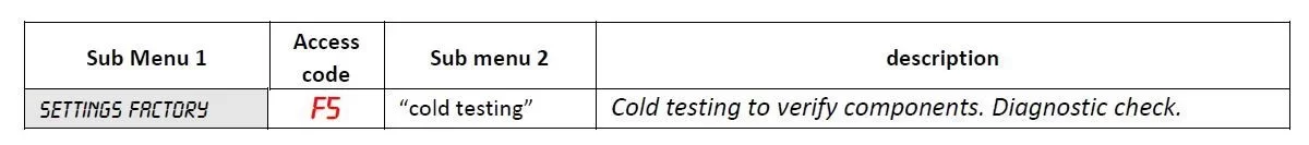

Cold test of all component
Now that the cleaning is done we can start to test the components of your stove it’s called, the cold test. You will need to enter in, the parameter menu first, let’s have a look at your control panel
[Hearth.com] Piazzetta pellets stove A to Z recommendations

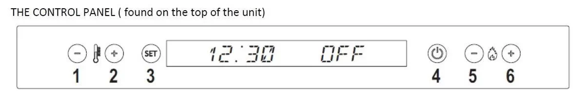

Take note of the numbers 1 to 6 below the control buttons [Hearth.com] Piazzetta pellets stove A to Z recommendations
It is possible to operate the electrical components individually (Igniter, Exhaust fan, Auger motor, Room fan) in order to do a diagnostic check on each component. The test may be carried out on each component separately or all at the same time.
To do so;
Press the 6 for 3 seconds
Press the 6 to scroll in menu select language, unit of measurement, set clock, set Chrono, energy saving and menu parameter.
Once at menu parameter press the 3 (set button)
Once setting factory appear press the 3 (set button) again
You will be ask for a code
Scroll up with 2, and down with 1, the code your looking for is F5 then press 3 for set

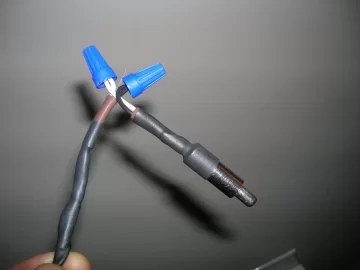

The igniter turns on (as you should hear a quick click) and the display shows the letter A.

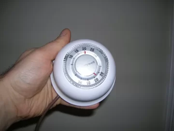

The use of an external thermostat
Is it needed? One example where you can spare the expense of an external thermostat is when the stove is installed in the basement and no one really live in it. You can cut the thermostat probe wire and extend it to the first floor with a same size wire. I did mine and I get to read on my stove the temperature that I have upstairs on the first floor where we mostly live. Sometime because of the sun coming true the windows I will get a 22-23 degree, mean will in the basement some time it can go down to 19 degree, I don’t want my stove to power up we are not using the basement.
Even do the Piazzetta stoves have all the possibility to be run by a sim card one cool thing about external thermostat is that some of them can be run by Wi-Fi and set and diagnosed from a smartphone.

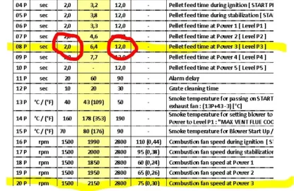

The default settings are mend to be use in a certain type of house, but since houses are not all built the same way in some cases we need to do a little fine tuning and it’s mostly all air related some house are well vented some are air sealed.
Note: you need to have a manometer to do the adjustments, some of the value have been updated by Piazzetta to be used in North America last formation 06-2015 Asolo Italy
these one are in french for who ever needs them; fichiers de programmation en français pour poêle; (Sabrina et Svena),( Monia et Marcella),( P955 et P958),( P960 P961 P962 et P963)

I Begin by disconnecting the cable of the igniter and securing it from heat,

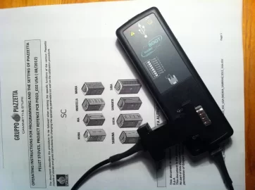

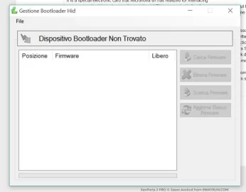

The use of a boot loader
usually you do not need this tool, only in very particular cases you will find this very helpful
the use of a boot loader is to reset a stove but not only has the default settings but to a full setting range I'll try to explain;
this is a boot loader you plug this in the back of the stoves so you can unlock all the settings
now what’s about it, well has you can see in the next image I have circled settings from Program P18, 2.0 being the minimum and 12 is the maximum adjustment for pellet feed. That's is true in the tech book only, in real life the stove default adjustments are way less permissive if I remember at Power level 3 you only can go from 5.9 to 7 ( time feed ) but what if you need more or less in another example the combustion blower settings are from 1500 to 2800 rpm but by default at level 3 will be from 1750 to 2300 if you need more you can’t unless you have this little boot loader to expand all setting and it gets very fun when you have different configuration example; using energy saver or not, or I had a customer who wanted to run is stove on solar system there a way to never stop the stove just like those thank stove, but to bring it down so much you wound believe there is a flame in there. Anyway they are so many adjustments I can do whit a Piazzetta its almost unbelievable that people are having problem whit this stove it's now my fifth years whit Piazzetta many sales and all of our customer are very satisfied whit the product and it as to stay that way Mont-Laurier is too small for customer problem.

I'm next door in New Brunswick and it's my 3rd year with the Piazzetta Sveva. Generally, I really like it, but I am currently having a problem with the external thermostat set up. First, I noticed that the room temp. sensor's original plastic plug had disintegrated, so I replaced it with a metal one of the same size (see pic below) and I at the same time I also tried to extend the temp. sensor wire by splicing in a 25' thermostat wire, but that didn't work for some reason - this morning I woke up to a room temp. of 30 degrees Celsius! I cut out the middle part of the thermostat wire and then spliced the white to white, black to black, as in my pic. Now, the room temp. sensor works again. This leads me to believe that the room temp. sensor did not fail because I reversed the wires, but because of voltage drop across the 25' length - I cannot think of another reason. (contd. below pic)

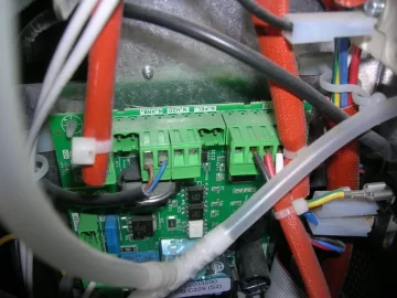

Consulting the manual, I then decided that my only option was to install an external thermostat. I read the manual's description on how to do this, opened the side of the stove, and installed the 2-wire thermostat wire, as the manual recommends. I attached the wires to the electronic board 2-pin terminal (N.H20 as labelled on the board). I took the pic below before I attached the thermostat wires - that's why the relevant 2-pin terminal is empty in this pic. (contd. below pic)
I connected the other end of the thermostat wire to a standard room thermostat, shown in the pic below (post contd. below pic)
My problem is that the manual states that the energy saving works either with the room sensor or else with the external thermostat. Since extending the room sensor did not work, I need to figure out how the energy saving works with the external thermostat. You mention that there is some kind of bug in the system. Do you have the contact info for Piazzetta tech support so that I can try and figure this out? Or, is there anything in my set-up that is obviously wrong?
Thanks for your help!!
I'm not sure about this now, same size but maybe not same capability, I would have it replace by the same one
Mine as around 20' and is working properly !? but from a fishing experiment I know you can put 90' and it would still work. ( if your interested I'll explain this one to you.)
There is no positive or negative side but I'm in doubt about the metal probe.
if an external thermostat is attached to the stove; you need to lower the internal thermostat of the stove to the minimum think it's 7 degree, so the stove will consider only the thermostat that as the highest temperature set ( hope I explain, so this make sense to you)
for the External thermostat, you had everything done properly, the bug is that the ENERGY SAVING will not work with your external thermostat. there is a way but you would need a technician with a boot loader and a newer version of firmware for you stove, and believe there are not many tech that have that boot loader and software. So my cheapest suggestion to you would be to get a new room sensor probe ( if you are in good terms with your dealer you can ask them to just make a claim and give you one), then splice it, and trie it back but with an wire identical to the original ( as small and multi tread wire, cause I think that usually, a real thermostat wire are single tread wire and may not react the same way to voltage)

Thank you v. much, Pascal! I will try this with my dealer and see what he says. So far, I have not been impressed with the dealer's follow-up, but we'll see. I'll post again when I've made some progress. Really appreciate you sharing your expertise!

Hi Pascal,
I am still waiting (since yesterday morning) for my dealer to call me back. In the meantime, I've been doing some more research and found an Italian forum (http://stufapellet.forumcommunity.net/?t=49875452) that claims you can upgrade your firmware by using the downloadable software called "SeramiNet" from the following MicroNova site: (broken link removed to http://www.micronovasrl.com/portal/default.asp?id=1301&lang=ita&sez=download) together with a cable - I assume a Plugable USB to RS-232 DB9 Serial Adapter like this one: http://www.amazon.ca/gp/product/B00...rd_t=36701&pf_rd_p=2055621862&pf_rd_i=desktop (I am also assuming that my SVEVA uses a MicroNova board - but please correct me if I am wrong)
So, after reading what the Italians say, I am wondering if I actually require the boot loader tool ((broken link removed to http://www.micronovasrl.com/Bootloader/)) or if it is just used to make firmware upgrades more convenient for technicians . . . ? I found one on ebay for less than $200 CAD ((broken link removed to http://www.ebay.com/itm/BOOT-LOADER-CONTROL-BOX-FOR-MICRONOVA-UNITe-DE-CONTROLE-POUR-MICRONOVA-/301134784002)), which might be less than the cost of a technician's visit??, but since I would only be doing v. occasional upgrades, I don't want the tool if I can simply use my computer.
[EDIT: I just found this in the manual for the SeramiNet software (translated by google): "Hardware requirements: To use this software you need to be in possession of the interface "serami".
It is a special electronic card that Micronova srl has realized for interfacing
a computer circuit boards manufactured by it." This means the Italian forum was wrong about how to connect- at this point, either you own the boot loader or else this other hardware. . . . I'll post again when I find more]
Even if this works, it leaves another issue because I would still require the firmware upgrade itself. The Italian forum, cited above, also claims that you can download the Piazzetta firmware through BitTorrent. However, do you know a more reliable source like maybe the Piazzetta's Italian website? Following your direction, I looked up my current version: SP40-B-V1-1-115.
Thanks again for your help. Please correct any errors in my admittedly layman's findings and sure, please also share the fishing story concerning the 90' long extension on your room sensor.
I'll update again once I've made more progress.
I have been to the site and download the software then I tried to open the firmware that I have, cause I do have a few copies of firmware no problem now I just dont have the proper cable to use with, the one I use for the boot loader is "Gestion Bootloader HID" its all Italian but it works well. ( this part as been change from original post ) I'm now able to upload My firmware in to the software but I just dont have a cable to transfer it to the stove.
By the way I did found the password to unlock the software but I just dont know what to do with it, I which we could make are own Firmware or just be able the make modifications out of it, I only played for an hour with it but it does look complicate to me, for now.
I purchase mine for 150$ Canadian
keep me informed on this if we can help more people with this it would be great.
that's my problem, I do have few firmware in my possession also one that fits Sabrina and Svena you will have to be very careful with this one, I do install the SP40_B_V_1_1_115 enr. but the version I have is totally unlock dont even ask me how I got this one, it was a mistake. but a mistake that helped me a lot. and also the software that goes with it. if you e-mail me I would be able to send you all this.
I'll send you a private message for this last one it has noting to do on this forum

sorry to interrupt, but if you go in the menu parameter, you will be ask for a code, hit ( F8 ) this will allow you to calibrate the stove temp with the room temp but not more then 4 degre up and 4 degree down in this case this it will do the job. no need to ad anything.

I have a few firmware and I can named them like I want so MV 1.1 dosent mean much to me as you can see bellow
and most of them have this F8 code to adjust the temperature reading on the stove display but I remember once going at an Piazzetta P963 owner and the stove did not even ad the ENERGY SAVING option on is stove, I had to update the firmware to correct this.
OK
I have SP 40 SC MV 1.1 and the previous firmware was SP 40 BV 1.1 115 ENCODER.enc (Firmware code H09900480) which I think had more options available (ambient temp probe cal) and maybe wider parameters settings for pellet drop and smoke fan
Regards
Gaston
