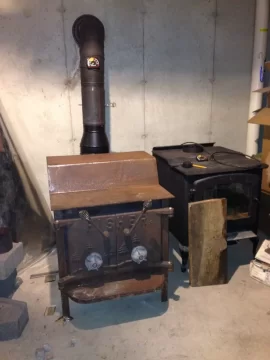

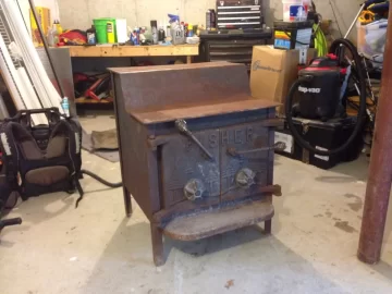

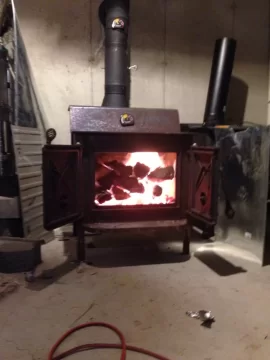

I took the doors to work and glass beaded them last summer, they are clean but I'll double check anyway. I'll double check the channel in the stove too. Also the right door latch was busted off at some point, they guy I got it from tried welding a latch to it but it just fell off so I welded some re-bar as a new latch and got the angle as best as I could. It is standing up nicely to the heat. I have a couple pictures I'll try to attach. If I get new pins I'll put some chrome on them to make them slick. The thing heats great though, almost seems to put more heat then the englander but doesn't last nearly as long.
[Hearth.com] How to run a grandma bear [Hearth.com] How to run a grandma bear
You can kinda see my rebar latch in the second photo

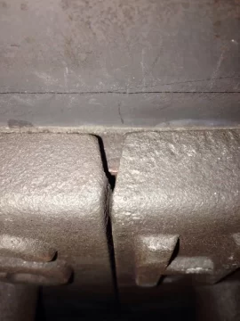

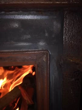

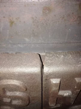

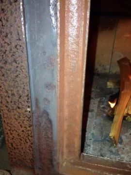

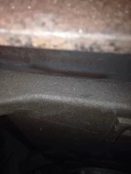

So like I said the I have already cleaned the doors with the sand blaster but I took a wire brush to the channel on the stove itself, the rust is very heavy so it didn't really help much. Nothing obvious is keeping it from sealing except for the rust pits. I took some pictures of the gaps between the doors, can tell me if it looks normal? Also I took some pictures of the channel on the stove to show how rusted it is. I'm guessing the leakage around the door seal if being caused by being warped or the rust in the channel. I wish I had a new one to compare everything. Any input helps, I know Coaly is filled with knowledge. Thanks guys

[Hearth.com] How to run a grandma bear [Hearth.com] How to run a grandma bear [Hearth.com] How to run a grandma bear [Hearth.com] How to run a grandma bear [Hearth.com] How to run a grandma bear
Got distracted, it's tough to see but there is a wider gap between the door and stove where the doors meet vs the outer edges. You can see the rust pits on the channel
Put a standard thickness piece of cardboard in the channel 1/2” wide on both sides where the hinges are. If you can shut the doors as normal add gasket. If you can’t find hinge pin I have them. Boxes of them. You should replace pins before adding gasket. If the doors are shut can the left door move slightly if you jiggle the handle. If so it will leak air. Add hinges then probably gasket. 7/8 flat gasket.

I went back and looked at the pictures Your locking handle is in the wrong position. Coaly is right about that. It is more for appearances unless when locked the right door does not seat tight. You can heat the elbow of the door latch then slide a 1/2” pipe over the end and bend towards the door slightly. Check handle position to match left side. It does not take much bending to do this.
My latch contacts the wedge on the top like it is supposed to. I'm pretty sure I got the handle angles and positions correct, I'll take better pictures after work today. I do remember one of the handles had to be heated up and bent away from the stove, can't remember which one though. It's dangerous the way it is right now, if you open it up just a little too much and look away for a couple minutes it'll start climbing past 750 quickly.
That was before I fixed it. The first picture I put up shows how it looks now
