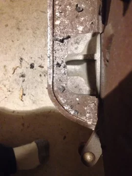

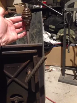

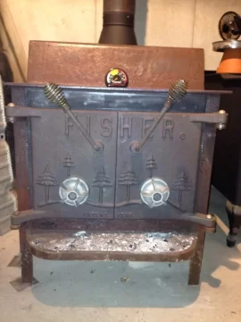

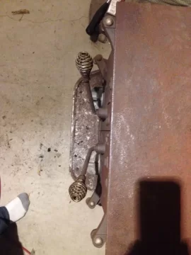

    The caps? Like the air knobs? Yes they are sealed good. Before adding those flat gaskets the only thing I can try is new hinge pins. I took some more pictures of the air know and the latches.

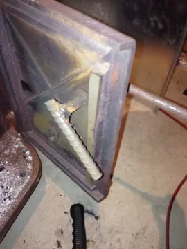

    Lol I’ve never seen a piece of rebar added to a door handle. If you ever want to change it out I have new handles for that stove.
    Hinges then gasket to fix it. Coaly does not like gasket on the old stoves because they did not come with it. But not all doors were hung correctly to maximize the air tight stove. Your choice.

    It's looking like I'll need a gasket to fix it. Seems like it'll be way more controllable if there is no leakage around the door seals. Almost 800 stove top degrees with the air knobs completely closed and pipe damper completely closed on a full load of wood doesn't seem normal to me. It wouldn't be possible with my englander, if I have a dry, full load of hard wood and a good draft I can close the primary air completely and watch the secondaries fire for a while before I need more primary air but I could not close the pipe damper all the way and expect to keep any flames.

    image.jpg A better look at the latch
