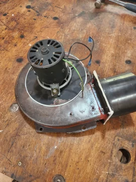

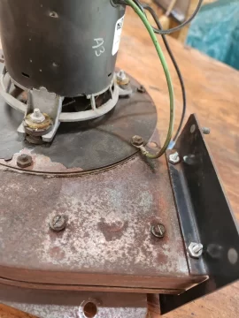

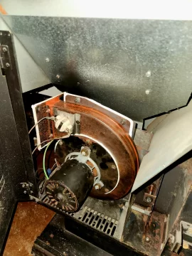

Got into the stove a bit.
-Took the combustion fan out. Cleaned that up.
-Flange that bolts onto the vent adapter was bent right up. Straightened that out.
-Screws that hold the flange to the fan were shot. Replace with bolts? Will add a pic.
-Exhaust damper was seized in the wide open position. Freed that up.
I'll keep posting here with my journey on bringing this thing back to life and my findings along the way

These are regular machine screws. If I did this I'd use stainless?
They don't seem to use any stainless building pellet stoves. I'd inspect them after a few years.

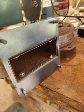

What temperature do combustion fans reach?
Can 500 degree rtv be used to seal the exit flange?

High Temp Gasket Maker RTV is good to 650F.

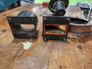

-I disassembled / cleaned / sealed the combustion fan housing.
-I used the Permatex red gasket rtv.
-The fresh air intake on the stove is 1 3/4". The OAK is 2"
-The flange at the exit of the combustion fan housing is 1.5 x 3 inches. Thats 4 1/2 square inches open for exhaust to flow through. 3 inch exhaust vent has 7 square inches to flow through. Not sure if that's how that works but seems sound enough for me to give try it.

-Remembered I needed to gasket the cleanout windows that have a plate bolted onto each side
-Broke a bolt that holds the plate on that I opened the other day. Drilled bolt out and retapped the hole. Ez-out wouldnt get it
-I just broke a bolt on the other side this evening
-Will have to work on the one that broke tonight, one evening or this weekend
-I've been using anti seize on all the bolts I mess with since I broke that first bolt

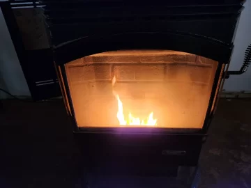

Stove stays running now.
Flame seems lively.
Flame gets bigger and smaller in height. Not sure if thats normal
Shooting a temp gun straight through the glass the fake bricks in the back stay at 470 degrees pretty constantly with the stove on medium
The exhaust damper is about 1/3 open. No idea how it was being used with it wide open.
When I initially fired the stove up, before I resealed the combustion fan, we smelled smoke bad. no smell at all now
The gasket on the ash pan seems questionable. Its easy to pull a dollar bill through it.
When I turn the 'Heat Output' knob from 50% down to about 30% the flame goes out. Seems to stop feeding pellets
