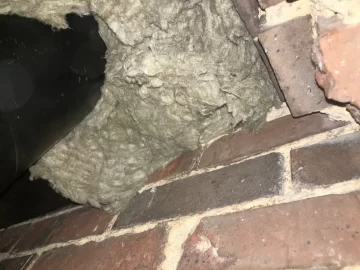

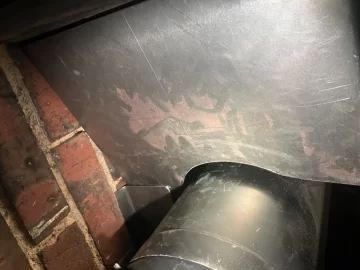

I put these block off plates in today and shoved a bunch of rock wool up the chimney. Also made this baffle to blow cold air behind the stove with the box fan. It seems to push air pretty good.

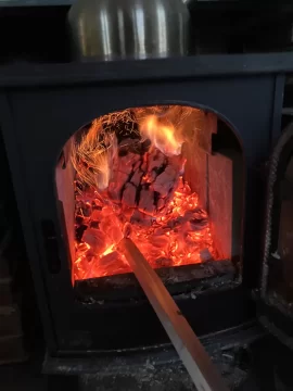

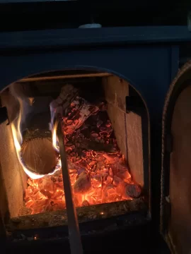

Doing a test burn right now. Similar conditions to the other night, starting at 68 degrees in the thermometer.

The rockwool should help a lot if you actually filled All the gaps around the pipe.
The block off plate looks unfinished, there seems to still be gaps around the pipe. It should be tight to block any moving air.
That's the whole purpose of the block off plate.... Block the air from moving past it.

There has to be enough clearance on the two pieces to maneuver them through the existing setup. The pictures of the block off plate are from the test fit up before I put the rockwool in. I used the rock wool to fill the gaps.
I think it helped. Stove burned good last night and the room warmed up a few degrees. Started at 68 and I think it read 73 when I went to bed two hours later. Did not cook us out of the house by any means.

2 hours is really not very long. Get that burning for a couple cycles of reload when the firebox just has coals left in it. See what happens after about 6 to 8 hours of burning (probably 2 or 3 burn cycles of load and reload on just coals). That will give that brick and interior contents of the house time to warm up.
Think of it more as recharging a battery (the whole house contents) vs. blast furnace for massive instant heat.
Reactions: Todd
Frankly i'd pull that fan / duct set up out. Especially while trying to figure out if your stove is burning correctly. The stove should start to warm that brick enclosure up and that will help warm your house as a heat sink. I also would wait to use any fan until that enclosure is very warm to hot. If it never gets hot then we still need to figure out if there is some other issue with the stove.
That's a very leaky block off plate. Add a plate or two to cover the large gaps. The better the seal the better the (heat) deal.
silicone is your friend to seal the block off
