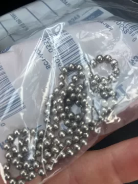

Local dealer can get the part in 2 weeks for$35, so I went on a treasure hunt. Because of the heat and soot I think it would be very inadvisable to use a plated steel chain from a hardware store. If you look they are all “chrome” which is plated carbon steel. They are not rated as strong and will be less resistant to heat and corrosion.
I looked and big box stores did not have stainless. Called around jewelry stores and craft supplies, no luck. After much searching i discovered that toilet pulls and drain plug chains (danco brand) are stainless and the correct size (#6 or 1/8” balls) I resolved to go buy some toilet plugs, but got very lucky at the local Ace hardware and they actually had 20” of stainless number 6. That was the only size they had in stainless and it was the last of the roll. It was $3. Feeling lucky today.

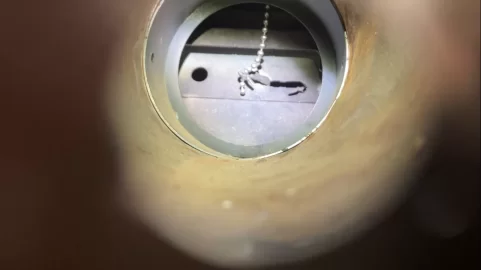

I got it installed. Since the old chain broke in two spot it was hard to know for sure how long it had been. I tried to get it close but ultimately just had to put it one there. I used a blowtorch to heat the probe and watched it move. I tried to get it to be fully closed at 900 F on the probe. But it was just a guess.

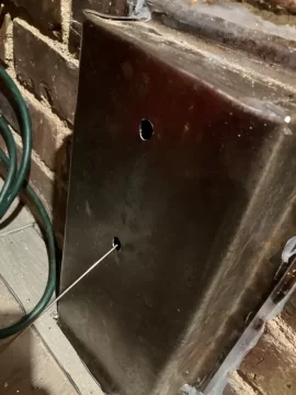

I got it back together and shoved the stove back it. It’s acting the same, going out as soon as I close the door. Now that I know where the valve is I realized I can see it if I drill a hole in my air intake. I did so and the flapper is fully closed at 300f stove top temp. Not sure how I will proceed. It’s a big pain in the ass to drag the stove out but now that I know how, it’d go faster.
With the new hole drilled in the air intake I can hold the flapper open with a wire. I’m going to try that and sit here to see how hot it gets

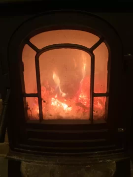

Works pretty good if you peg the flap open. Probably the first time I’ve ever felt it put out heat like this.

How is your "air intake" set up?
Yeah. Looking at the pics again, I’m not sure what’s going on here. I thought he drilled a bigger hole in the damper and used a wire like I did with the pencil.
I want to see what happens if we remove the duct going into the Outside Air, and just let it breathe air from the room. If it’s an old leaky house it won’t need that duct work anyway. Sounds like there is a restriction in the duct work or it doesn’t go where we think it goes.

It was set up without an outside air intake the first year we had it and it behaved exactly the same way. Here is a cross section drawing I made on my phone of the setup. The sheet metal ducts down into the Crawlspace. It’s like a box that’s been sealed to the brick chimney. The flow restriction is very minimal. The cross section is comparable to the 4” duct. It goes down to to the Crawlspace and hooks into a flexible duct. Because of the way the chimney and the joists are this is favorable way to do this and I did not actually have to drill a 4” hole in the floor. There is a 2” gap between the brick stack below the chimney and the joist. If fits in there.

How has it been burning today?
It’s been alright. Definitely hotter but never 850 on the cooktop. Maybe 750. With the flapper open in burns with big flames and keeps the glass clean really well. I have never seen it keep the glass so clean.

850 is hot.
700F or 750F seems a very good running temp.
At 675F on my f400 that's about as hot as i let it get.
Cruising for the f400 is usually 500-650F Range
