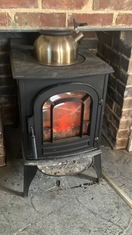

I have a VC Aspen C3 that I bought new in 2023. We installed it in February of 2024 and so didn’t use it much that year. It’s set back into an old brick fireplace as you can see in the picture.
Last winter we used it a good bit and found it struggles to put out any heat at all. Our house is VERY small and it could barely warm up the 12x12 living room. We put it up to our wood not being well seasoned. I build a lean to for the wood and it’s been sitting dry and covered for another year. It’s white oak, soft maple and sweetgum.
Well this year it’s been just as bad. It doesn’t seem to matter how small I split it or how well I stack it. As soon as I close the door the fire simmers down and the stove makes charcoal in the back and only has a lazy flame at the front, or just red coals. I can not boil a pot of water on the cook top. It will simmer but never breach a rolling boil. It does not come close to heating our 700sqft house. I believe the automatic air control is to blame. The chimney and cold air intake are clear. The wood is dry.
Is there anything I can do to fix this? Some adjustment for the air thermostat? I am not sure if the thermostat is supposed to go by room temp or combustion temp, maybe being in the brick alcove is making it sense warmer than it should?

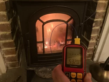

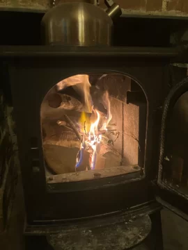

Here is a video of how I operate the stove.
Cooktop surface measured up to 600F after 2 hours but the kettle just sits there and “tsshhhhhh” never boils proper.
The wood mostly measured 2-5 Mohms which for hardwood I believe is mid teens moisture percent. The big sweetgum split I loaded measured OL, it was very dry.
Chimney cap is not plugged and chimney is nowhere near clogged, I checked yesterday.

Something is up with your draft. Sparks and smoke shouldn’t be coming out during reloads like that. Are your liner connections ok?
Also, (I didn't have the sound on), did you resplit the wood right before you measured it? (And it's room temp, right?)
Reactions: Todd
The stovetop temp, if I remember correctly, the cooktop portion will read much higher than the cast top of the stove... the fire still seemed kinda sluggish too, I'm curious when you first start the stove, does the flame change in its movement as the stove heats up? This stove has a thermostatic draft system I believe? You don't manually control the primary air? I'm wondering if therein lies the issue... or may be part of the issue. Good luck with her.

The load looks a bit small and loose instead of packed on a coal bed. If the wood is not fully seasoned, heat output will be reduced.

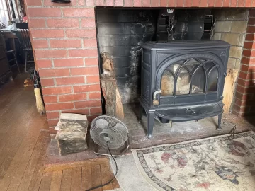

I was looking at it and pondering today and I think I before I tear it up I am going to put a block off above the stove and make some kind of temporary baffle to blow cool air behind the stove with a box fan. We’ll see if that makes a difference.
If there’s no block off plate maybe temporarily stuff some rock wool insulation up there to see if it makes a difference.
A small fan on the floor in front of the stove blowing into the fireplace may help push the heat out.

I will make block off plate and put rockwool behind it tonight. I have tried extensive fan configurations and none have made a big difference. There’s a box fan blowing over it right now. One I thought was sure to be successful was a fan in a secondary flue in the back of the chimney blowing air down and around the stove, countercurrent to the rising heat. You could feel the warm air gently coming out of the stove. I think it helped a little but not so much it was worth the noise of the 6” exhaust fan droning
Reactions: Todd
You want a small fan, on low, on the floor pointed under and up a bit from a corner.
You are trying to get the coldest floor air and gently push it around and up a bit to just help increase the rising heat from the stove.
If the fan is to high and you overly mix the cold air with the warm air that can sometimes not help as much unless the area around the stove is very hot. (which in your case it could be).
I also second the "Check your draft" possibly for a blockage, as there is No Way sparks should be flying out the front like that.

With 600F stovetop you should be getting cooked out of your house.
If it was me i'd rear vent that to get it out further.
