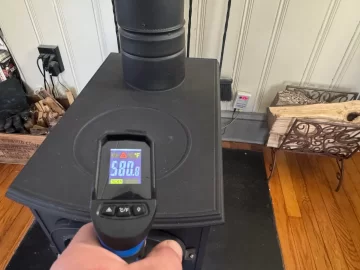

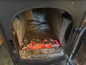

11:45 Im sitting at 70 in the hall, 580 STT and the pine is chewing the coals up. By the time this pine is ready for a reload I’ll just have nice ash in the bottom.
Outside them is 34 at the moment.

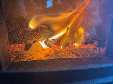

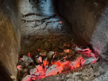

I got busy doing my work and phone calls and forgot about the stove till I heard the furnace kick on. So, in about the last 5 hrs, the rest of the hardwood coals and those two pine splits disappeared. Granted, it’s probably not been pushing much heat for the last couple hours either, but I raked it around and it lit right off with a piece of pine and a half a holly log. Pulled the coals up in a pile up front, and there is a flat bed of ash in the back.
Point being in my area, if I only ever collected pine from here on out, it wouldn’t bother me. Pine will heat hot and fast, and reduce coals to nothing. The C3 is not a passive stove. You have to tend it every 3-5 hrs for best results. I can put a beast of a log in for an overnight burn, but you’ll wake up to 120 STT if you sleep 8 hrs.

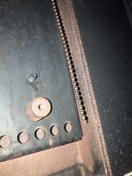

it’s really just a metal coil on the end of a probe that has a ceiling fan chain hanging off of it. The lower end of the chain hooks to the flap that is the primary and secondary air damper.
I have adjusted my chain by moving the connection to the flap a link or two shorter. I’m not sure what happens if you go too far.

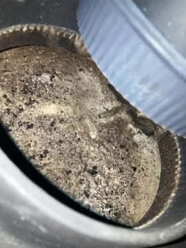

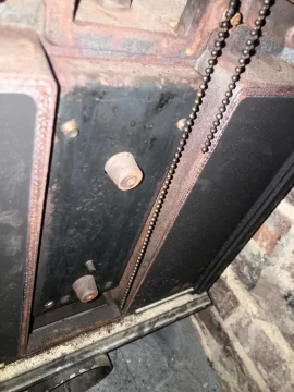

I pulled the stove out with some effort just now and took the back plate off. It is not cogged with and and the stove pipe is clear, as you can see in the pictures.

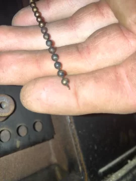

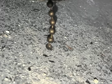

However when I moved the chain up and down gentry with my fingers to verify the plate opened and closed freely is BROKE IN MY HAND
The little ball chain is somehow mangled and cracked. You can see the ball below the broken one is cracked.
I am contemplating how to proceed. I am sick of this stupid POS and I wish I had gotten a Jotul with a normal manual air control

Understand the frustration, but at least hopefully you can get that fixed, and it will work correctly in future. Your tenacity and persistence has seemed to find the issue at least. Good luck.
