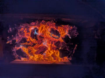

I have personally gotten over 14 hour burns with the same stove. Wood loading is important. I process my own wood so for overnight my splits are squared and rectangle and very little space is left after loading for the night. I'm also burning oak well seasoned. The other day I loaded my box only 3/4full and this is what my stove looked like after 10 hours

Something doesn't seem right with the air flow. I regularly go 7:00 PM to 4:30-5:00 AM with a solid bed of coals where I can put splits right on and have the cat re-engaged in about 20 minutes. Overnight I generally keep my air about 20% open. Colder nights a little more which lowers burn times but If you need the extra heat you gotta do it. Like @Woodsplitter67 mentioned you want it packed tight with minimal space between each split.
