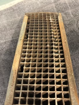

I don't think the cracking is bad. But it does indicate something is not going as it should be.
I would be more concerned about the color; you're pushing gases through when it's not hot enough, leading to deposits rather than combustion.
And these deposits are covering the active (precious) metals, meaning it might not do its job now.
I suggest a cat wash is needed, and then you need to better get it up to temp before engaging it. (This may have gone wrong due to a bad cat probe, tho).
And you need to make sure you're not running too close to the minimum, and run into cat stalls (where it doesn't combust anymore, and deposits like this happen).
That's a ceramic cat, no? Cracks shouldn't matter as long as the pieces remain intact and in place.

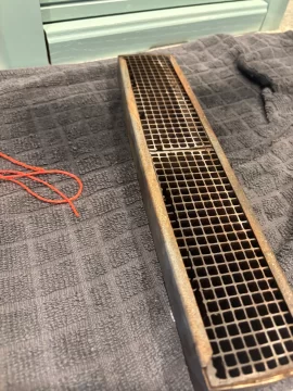

In other news. I had not seen the most recent posts until just now. Cleaned the cat with 50/50 white vinegar solution. Let it soak for an hour then dipped it in boiling water for 15 min. I lightly scrubbed it when it was soaking in the vinegar. Attached are the results. I don’t think it did much.

Don't scrub the cat as you'll remove the precious metal atoms that do the job of the cat.
Yes, And don't worry about discoloration too much, just make sure the honeycomb is clear for air to pass through.
Reactions: Turbo89

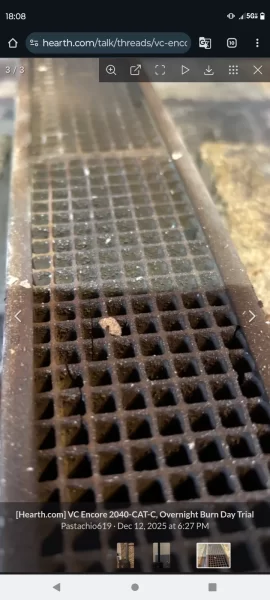

Discoloration is not a problem. Coating a cat with black stuff means it wasn't hot enough when crap was fed thru it.
And coating a cat means it's inactive until heat from the firebox (and not produced by the cat itself) cleans it off, as the active metals are buried.
The cat was coated if you look at the images.(I zoomed in and took a screenshot).

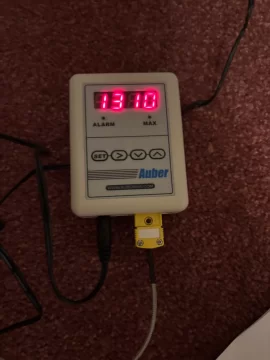

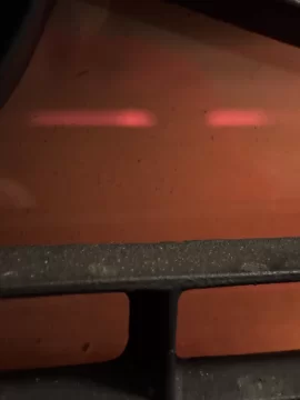

I have seen the light. I have seen the glow of the cat. I thought I may never see the day.
That was undoubtedly an amateur cat cleaning job. But something happened. Just needed a little TLC. Soft touch of a scrub daddy and distilled white vinegar and the kitty is roaring.
No flames going through. Just glowing bright red. I have the primary cranked all the way down and SHES SMOKIN HOT.
all I needed was the Auber set up to know what the hell was going on back there and to take the cat out for some 1v1 time.

Real time feedback is important when running this stove. You may see some high spikes in cat temp as you figure out your process but don’t panic. I hit 1600+ recently with the air cut all the way.
Did you take the ceramic panels on the face of the refractory off when you installed the probe? You just don’t want it touching a surface is why I ask. I marked my probe with a permanent marker so if I bumped it I knew where it needed to be.
