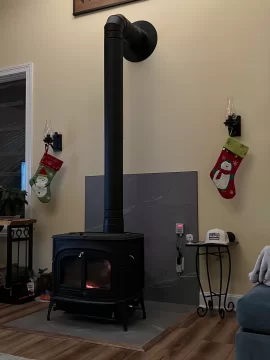

Attached is my set up. 6" diameter pipe, one turn. I am not sure the height of my chimney, I went out and measured the best I could from the ground I would guess 20' tall.

Few things I see: all too familiar of a setup since my setup is very similar.
- I second/third getting the digital probe ASAP. I held off 6+ months and all I got was creosote in the lower single wall interior pipe. I grew up on an old jotul - where you just throw wood in and close the dampener and walk away, needless to say that’s not how this stove operates. And the digital probe is how to run these.
-1 visible 90 + another 90 to turn up in to the chimney- this “deducts” from over all stack height calculations by 6’ - I mention this if puffing comes an issue. This stove wants a min of 16’ overall. My installer apparently wasn’t great at math.
- see if there is any correlation to the back puffing to bath vent fans or hvac units running, high winds can also cause some down draft issues. Houses that are tight (mine) will be more prone to lack of draft, I even have an outside air intake direct to the stove.

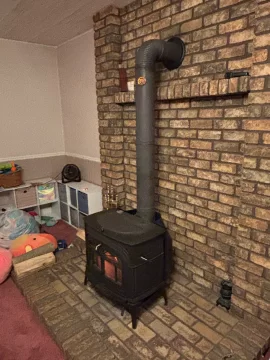

Good looking fire to me:
-Strong coal bed glowing, dark above
- little to no flames, maybe a wispy few in the back.
- cat temps 1200+ during the burn.
-dirty glass (means long slow burns in the box, it cleans itself upon relight in the morning)

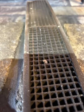

ok I got the Auber A100 set up. The original CAT probe that came with the stove was in terrible shape and would not provide a reading anymore. I am surprised it was in such bad shape considering the stove was installed in 2024.
Once I installed the probe I removed the plates and pulled out the cat to check the probe depth. Since I had it out I checked the cat again and this time noticed some cracking. See the attached photo. This is the only cracking I noticed. How big of a deal is this?
Also, how long do these Auber probes typically last?
