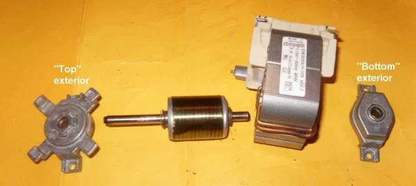

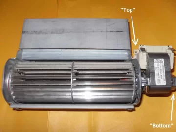

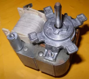

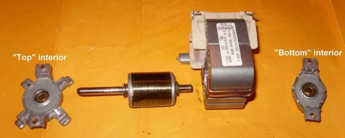

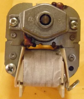

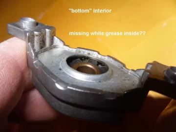

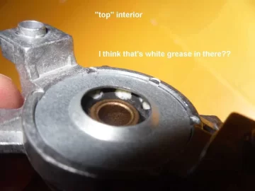

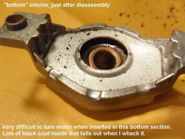

Hi. Here's more info:
Opened stove panel and found one fan had stopped turning. Turning by hand was difficult.
I removed from stove and dissassembled.
I arbitrarily labeled motor so I can discuss: one part "top", and other part "bottom."
Dissasembled per photos attached.
When top and bottom parts are viewed from "interior", looks like they are packed with (maybe) white grease?
Bottom had lots of dry black crud which I shook out, and then cleaned out with Qtip. It is the bottom part that had most resistance to turning, even after cleaning.
So I used "turbine" oil (which says it's specially made for fans) and oiled top and bottom interiors, and reassembled. Turns much smoother.
It's running fine now, but...
What was that white grease stuff?
What was that black stuff??
And how long should I expect this to last before next dissassembly? (we run stove almost constantly during last 2months)
And did I perform appropriate maintenance, or should I do something differently?
Thanks!
-Theodore.

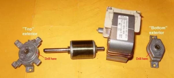

The bronze bushings on both sides of the armature are the bearings. There is usually a felt packing around them that holds oil for lubrication. I think this is the white "grease" you are seeing. Take a toothpick and poke at it. Does it seem fibrous? This felt is lubricated then sealed at the factory and works until they dry out. You can make them serviceable by carefully drilling an 1/8" oil hole to the felt so that lubricant can be regularly added to the felt without pulling apart the motor. Be sure to clean up any metal filings first. Then use around 10-15 drops of light oil like 3in1 per bearing once a year. Don't use something like WD40 which is not a lubricant. Or you can carefully soak the felt while it is apart, then put together and let it go another 5 years.

Begreen's right, WD-40 is not a lubricant. It is however great at removing grease and crud. I always thought bronze bushings relied on dry lubrication, meaning either self lubricated (impregnated) or graphite etc. in this type of setup, you defintately want this feature as ash and dust are present. Any type of liquid or grease added into the bearing/shaft contact area will attract the ash and dust and accelerate wear. If you think you see some black crud now, keeping adding wd-40 or oil and see what happens then. I bet theres lots of black crud and an oval bearing. I am not familar with the type of bearing design shown above, but it looks like the porous bushing slowly absorbs grease into the bearing, if it is indeed grease. That would allow just a thin film of lubricant which will not attract as much dirt. My Jotul utilizes similar bearings so i will be looking into it in the near future, i think you just jump started me so i am ready.
There are lots of types of sleeve bearings and some are graphite impregnated, but I have found the porous bronze oil impregnated the most common. That's why I said take a poke at that white stuff. If it is fibrous, it most likely is white felt.
I used a toothpick to poke at it. Not fibrous, but creamy, which is why I thought white grease.
Unfortunately I'm not too knowledgeable on what to do next with it/how to maintain, other than cleaning and coating generously in oil and reassembling.
Should I go buy some white grease and pack it in??
