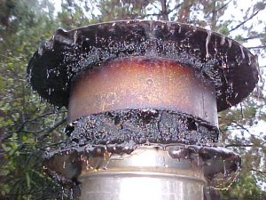

Coals after a good fire do not form creosote. Creosote is formed from the stuff including water vapor that is "boiled off" from the wood during the initial phases of the fire, if the fire is not hot enough then this mix of water vapor and gases convert back to solids that collect on cooler surfaces in the stack. By the time you are ready to go to bed after a few hours of burning, the wood has been boiled and baked so the only thing left is mostly coals containing carbon. If the fire is hot enough the coals burn completely to CO2, if its not hot enough they burn partially to CO (carbon monoxide). Both of these combustion byproducts can not form creosote as they are non condensable gases. They hopefully go up the stack.
The worst thing to do is throw some logs on and crank the air down to keep a bed of coals until the morning as the logs will "boil" away at low temperature and head up the stack to point where the gases condense on the cooler chimney walls and turn into creosote.

Black glass could be just some soot (thin dry almost dusty layer, and wipes off easily with a damp paper towel...which I guess technically is stage 1 creosote) or it could be legit creosote, stage 2 or 3...hard to say without seeing it.
As was stated. black glass means wet wood, or air setting too low, or possibly loss of draft during the night (which could have quite a few different causes)
