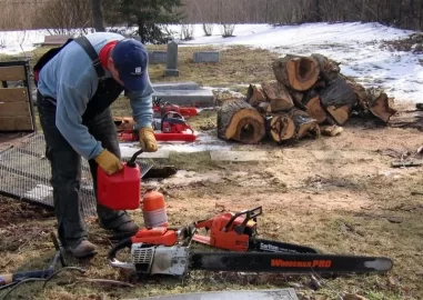

Tips are wear items, especially where the bar steel is particularly good and well hardened, and they can fail in the field. The ability to swap out a bad tip with nothing more than a punch, hammer, and a stump, is a nice bit of insurance that you can keep working without having to hike back to the truck or drive back to the shop/house. On a more expensive bar, the ability to replace a $12 tip makes a lot of sense. The 42" WP bar in the foreground has gone through a couple tips in its lifetime, and started life as a .404" pitch setup and is now 3/8". The 16" Carlton was a $16.95 bar/chain combo from Bailey's, and is pretty much disposable.
For your 359, which is what I presume you're looking to put the 24" bar on, Windsor SpeedTip (which is what I'd choose) or Oregon PowerMatch would both work fine. I think you can get an Oregon ProLite (???) in 24", which would save you a bit of weight out front and save you a couple bucks, and would make sense if you're not going to be running it day in and day out.
