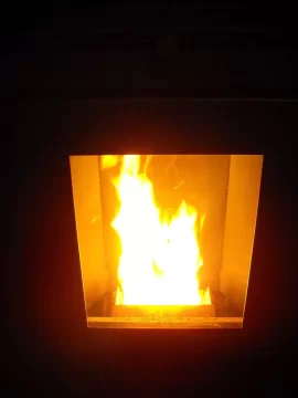

Oh, Well I tried the $10.00 Damper just now and it works great!
You can really turn the intake air down to stop the popcorn effect so there are no more un-burned pellets popping out!
Works great on Lo now. Video below is running at Heat Level 3
See video of stove Burning after air leak fixes with new updated modified burn pot with new gasket around burn pot and new air intake damper on back.

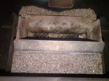

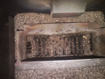

Ok, So to show how the Burn Pot Fixes went, I took 2 pics of the ashes after a burn. Looking good. Only 1 partial un-burned pellet!
Here is a list of all the fixes!
1. Upgraded Burn Pot without the crisscross bars on the bottom so more air goes thru the pot!
2. New Gasket around the outside of the burn pot above the cradle lip.
No air goes around the burn pot anymore
3. New Air Damper on 3" Air Intake tube on back.
Now I can limit the air and stop the popcorn effect that leaves unburned pellets around the pot.
4. Back edge of burn pot is bent back at a 45 Deg angle.
This way no pellets fall behind the burn pot!
5. Cleaned Ash traps and Cut Gaskets from 1/8" thick High temp Orange Silicon Re-usable rubber! Durometer = 70A on the hardness scale.
Orange Hi Temp Silicon Rubber available from Amazon here. Nice and thick so it will last a long time!
http://www.amazon.com/dp/B005JFRB7Q/ref=biss_dp_t_asn
Also see ah trap pics > https://www.hearth.com/talk/threads...-traps-how-often-do-they-need-cleaning.88067/
The stove is burning like never before! Perfectly!
