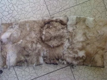

Here is a pic of the insulation. Its torn to the right of the black ring. Its 2 pieces here i just laid them side by side for the pic.
Clearly seen is the carbon black ring where it was lodged into the top collar. Even after fire was out it was pulled up into the flue.

Most diagrams I've seen show a weight on the blanket. My insert was supposed to have 1/2" of the stuff on top of the brick baffle. I tried with and without and could not tell any difference. And it made cleaning a pain so I pulled it. When I did have it in there I used and old circular saw blade as a weight.

You may be able to just replace it properly and it will be fine, but as someone else suggested, you may be able to get a rigid insulating ceramic plate to replace the blanket if you don't want to risk that again. Some stoves use them instead of the fluffy stuff. They're like the shields used on the Space Shuttle. Or maybe glue the blanket down with stove glue or something. Just random thoughts.

I would consider adding a couple weights on top of the blanket. Can you get hold of some 3/16" steel flat stock? If so, make some ~2" x 12" flat strips. Install the insulation blanket, then lay the strips on top of the blanket to the left and right of the flue collar opening.

My stove has a similar ceramic wool blanket but there's a metal weight, a disc about 4.5" in diameter that goes on top of it right in the middle.
You can operate the stove without the blanket, but I think it works better with. Sounds like you need one of those weights.
