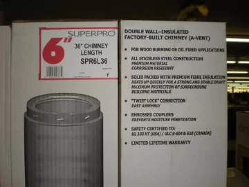

why does my local Farm and Home supply store sell it for just a few cents under $80?!?!?!?
Should I buy out their entire stock at my next paycheck and sell them all on ebay? what's the deal?

it is selkirk, but the box (pictured above - taken in the store tonight) clearly says SuperPro
I keep hearing it's a lesser grade, even "dangerous". So were the folks at Selkirk lying to me when I called and asked directly whether the Supervent was a lesser grade and they assured me they don't make a lesser grade? If it's UL 103HT listed, is UL lying as well? What gives? Why doesn't someone from Selkirk get on here and settle this. I keep seeing the same arguments and I'm prone to think it's from the retailers that want to charge $180 for a piece of pipe that could be had at the box stores for $65.

"Lesser Grade" Like the builder grade cabinets and appliances in a new house, they perform the same and sometimes look much like their counterparts, I went to the Professional Hearth Store and SuperPro was $140 a length so I went down the road to lowes and bought the SuperVent for $60 a length, everything else in my house is "builder grade" so I felt that this chimney was good enough for me!
I bought the superpro from my local farm supply store. It was 69.99 for 36in section. Warrenty is 25 years on the superpro, i believe 10 or 15 years on the supervent. The superpro may have a higher grade stainless steel but i am not sure.
Look for the HT fellas. HT = High temp. If its got that moniker in its name, you are good to go.
