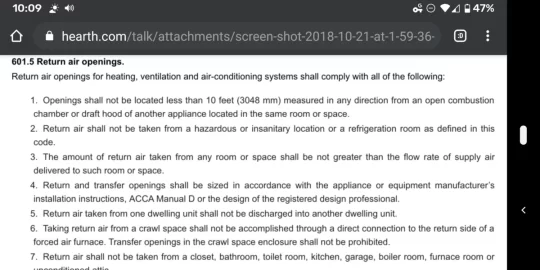

Thank you found this.

so is the stove door considered an open combustion chamber? Even if the door is closed? That code is actually pretty weak.
The "open combustion chamber" should refer to something more like a fireplace or even a built in grill; usually built into the masonry chimney. Even the older style natural draft water heaters may be considered open combustion.
The codes are written so that the return air opening will not defeat the drafting of any other open combustion chamber appliance when operating.
So if there is an outside air adapter does this meet the code for 10' clearances? This is assuming the code is intended to keep the return from interfering with the draft.
No you still need the 10'
The reason it still has to be 10’ is b/c you will still have to open the door to load wood and there is the chance not all of the combustion air comes from the outside air pipe.
