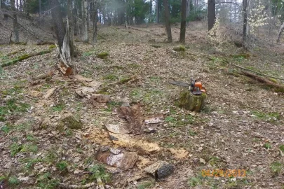

I had a stump that was in the middle of a new trail, the 390 took care of that.
