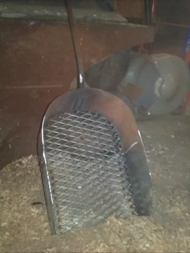

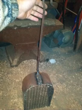

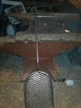

After having over a week of solidly cold weather (finally), I had to empty the firebox out last evening, the ash and coals were really getting deep. I've found when you burn lots of locust, and burn it hard, the coals like to last alot longer that some woods, and that can be a problem for reloading when you want to get the temps up quicker. Coals get covered (and smothered) with ash, which in turn insulates the coals and they last a really long time (sometimes days). I whipped up the idea for this sifter hoping that if I sifted those big coals up and out of the ash bed, that they would burn off better and allow me to empty just the ash when I needed to. And it does that job perfectly....
I had some expanded metal (heavy duty stuff, not the metal lath you use on parge coating or plaster work), some scraps of heavy guage sheet metal laying around, and an old el-cheapo fireplace shovel that I used the handle off of. So I pieced my experimental sifter/shovel together...
[Hearth.com] I finally built that coal sifter I've been wanting.... [Hearth.com] I finally built that coal sifter I've been wanting.... [Hearth.com] I finally built that coal sifter I've been wanting....
The ones you can purchase are dinky tin coal shovels with a couple of small holes poked in them......not nearly enough room to sift. I made the sidewalls of mine over 3 1/2" tall to accomodate some sifting action. The entire bottom is expanded metal, too. Works really good!
Not bad for 25 minutes of work, eh?
The part that really impressed me was that by bringing up all those coals out of the insulating ash, it allowed them to burn off faster, and allowed for a faster reload. While I won't have a constant need to use it, I feel it was worth building. Can't ever have too many tools or gadgets laying around if you ask me!

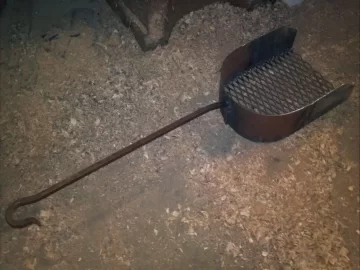

Scotty It's just low around here so this frozen ground has me on the gather stage or wood procurement. I just was granted permission to take wood from the 80 acres across the street for a face cord stacked outside his garage. There is unlimited ash and maple down in that wood lot with a whole lot of oak mixed in. His woods is low too so I need to "get it before it rots"!! Or before the mud season. My plan is to go "Scotty Overkill" on the wood I stack for him and even top cover it with plastic. I will trade a face or so per yr for access anytime and want him to be happy when he shows up. He just comes out here on weekends and burns in a fireplace. If the weather returns to frozen by the weekend I will be cutting - it it is sloppy I will be forging.
Reactions: ScotO
Thats sweet, I want one
Reactions: ScotO and Defiant
Great Idea, like the high sides, looks like a good candidate for brazing it together, only scrap I have around is to big, from building a loading ramp.
I will have to look around to see where I can get a small amount of something similar, any ideas ?
Coffee can cut down a piece of heavy gauge 1/4" screen over one end and a piece of conduit pieces brazed together = sifter , been using it for years.
Where is the pics ;?
I will get a pic tonight, then fun begins trying to post it
