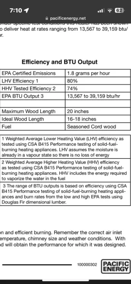

Can someone break this down to me, with the btu/ 39,159 of heat, why does it have to be on higher setting,? why can’t I get that on low, when everyone is telling me to turn down the air control. I will think that’s the btu I should be getting on low
[Hearth.com] I have a pacific energy summit
EPA testing is done with a fixed amount of softwood fuel. This is not the same as realworld cordwood burning. The stove is most efficient and puts out the most heat when the air is turned down enough so that secondary combustion is maximized and less heat is going up the flue. It does not have to be on a 'higher setting'. If the goal is to realize room heating efficiency, then insulate the basement walls to eliminate that major heat loss.
You get most heat per load (!) out of the stove when it's burning most efficiently. That is with the air turned down, as begreen points out.
But you get most heat per hour (!) out of the stove when burning high. That is less efficient (i.e. the ratio of BTUs into your room vs out of the chimney is less favorable). Your load.of fuel will last less long burning high because more of it is going into your room per hour and up your chimney per hour.

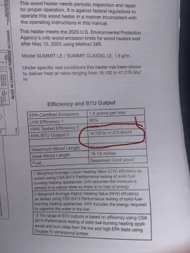

I just got a new summit LE the stove was made in August 10,2025 it feels totally different. As I was going through the book for the stove I see the heating got better. The old one is above
  • [Hearth.com] I have a pacific energy summit
Difference in epa testing methods. Probably no change in the stove
