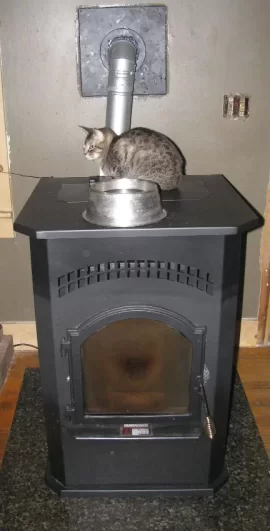

Finally had a cool night. Fired her up this AM on Auto and she ignited like a champ. So... problem solved. She has cycled through a off and back on... no problem at all reigniting. Thanks all. will snap some pics when I can remember to get my camera from the office.
Nate
Still do not see any pics!
Just another stove :)

Is that the thermocouple wire going out the window ? That suppose to be at the floor . Could cause problems .Manual says.
Jus wrapped around a tie-back on my picture window beside the stove. When you have cats/dogs in the house... the words 'on the floor' do not apply unless you want to be ordering a new thermo every week. 'Ain't Nobody Got Time For That'
