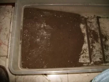

Not too bad for 5 months of burning. The last month or so I was burning pretty wet stuff. Atleast is was brown and flakey.

I dont think I have ever seen it brown. You have a lil more than I did. What does the liner look like?

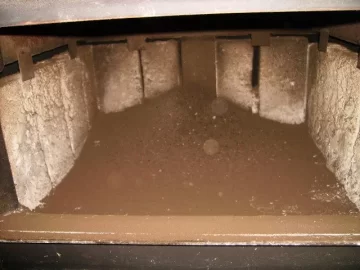

What in the world happened to those firebricks karl? :grrr:
LMFAO I was just thinking the same thing.
Beats the hell out of me Bart. When I cleaned it out, I was thinking that is was some cheap fire brick and I would have to replace it next year.
The liner looks great.
Got any ideas on what caused it? I really do not think I over fired it last year. I didn't have a thermometer on it, but I kept the air control within an inch of closed all the time except when first getting a fire going.
I am puzzled. I don't think it is from overfiring. I overfired the crap out of my old stove for 20 years and it didn't hurt the bricks. And I am going into season three with the 30 and the bricks look like the day they were made. I have to suspect that PE has started using the softer pumice bricks but haven't heard of it.
If you pass by a stove shop pick up a regular firebrick for a couple of bucks and see it is heavier than the ones in your stove.
PE does use the "softer" less dense bricks. But hell my bricks going on 3rd season are not that bad. I know from throwing bigger splits in and ones with jagged limbed nubbs and such they beat up the side bricks.
And of course the poker I used to situate things around, sometimes I end up catching the brick. I know these things cause some of the brick chipping & deterioration.
But man, those look like they were beat with a ball peen hammer.
I don't use a poker. Just a little scooper to take the ash out with. I know the chipped brick in the back is from splits hitting it when I put them in. That one happened pretty early in my burning and I started being much more careful after that.
I think I'm going to turn them around and see how they hold up this year, then probably replace them.
These are really light bricks.
