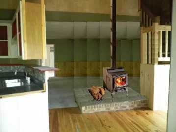

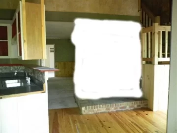

WOW, what a perfect location for a stove...
First I apolize for my non existant skills with photo editing
Many here may disagree but,
With out a doubt this is what I would do
I would add in what ever code requires for support for ceiling and install a Lopi endeavor size, or larger stove of you choice to the existing chimney

WidowMaker said:
Lisa*Ann said:
Here are pics of the fireplace from both sides. It's a metal pre-fab.......
I'm laughing my head off right now at that picture!!!!!!!!!!!! LOL!

Glad ya got a kick out of it...actually it a non picture, but thats is exactly what I would do...
Well... it's far from perfect, but this is what I managed to come up with using a Lopi Endeavor...
