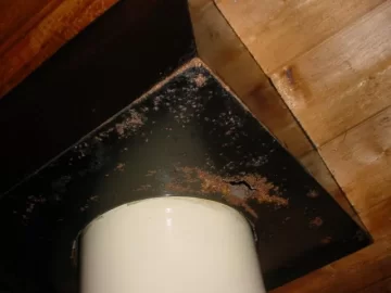

The rust problem we believe stems from our previous roof. Before the roof was replaced if it would rain hard we would have water drizzle down the side of the chimney. My father in law had this house built and told us that was always a problem that it was hard to get a good seal. We had the roof replaced and had the same problem once but the roofer came out and sealed around the chimney on the roof real well because we have not had that problem since then. So the support box damage has been from years of this problem we think. I've called the company that made the fireplace and they were not much help. I guess it's just the it's older and trying to find a replacement seems next to impossible. I have included some pictures and if you have any more suggestions we would greatly appreciate it.

Certainly looks like Dura Vent, which would make sense since there were only a fee companies around back then that made such things. The company that made the fireplace (malm?) should know the brand names of chimney that were usually used. Again, my guess is Dura - check out their catalogs online and see if something matches the dimensions.
If you really get stuck, you should replace the whole chimney. Chances are that it is near the end of it's design life (20-30 years).
