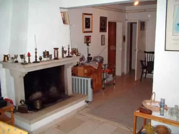

My house doesn't have fireplace stuff inbuilt in the masonry. (I've already talked a lot about my house in this thread https://www.hearth.com/talk/threads/6287/ and there's also a pic of the place where the fireplace is going to be).
This seems to be a little problem - I've been looking around to find pictures of completed fireplaces to get some ideas on how we'll be finishing it off, yet I keep finding only pics where the insert is actually inserted in the wall. Probably that's the way inserts should be... and my insert is more of an 'outsert' so to speak! :lol:
I've browsed the entire gallery here... the way our completed fireplace should look is like the picture I'm going to attach (it's from the gallery), but with an insert fitted inside. Notice how the chimney goes up on the outside through the mantlepiece. The whole thing wouldn't be flush with the wall, but jutting all around.
Do you have any idea where I can find similar pictures?

The finish of my house is somewhat classic/rustic. I was looking for something with stone/brick/marble/granite designs. Preferably no wood. We got enough mahogany in the house...
