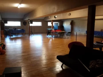

After reviewing the US stove 3000 vrs the Vogelzang ponderosa, I think the United States Stove 3000 is the model I am getting.
I will be installing it in the great room of my house.
the house is a single story, with a drywall ceiling, with cellulous blown insulation, then a sheet steel roof. So, I think my most efficient way to install the chimney would be straight up and out the roof.
the room is 36ft x 60 feet with a beamed ceiling, the beams were covered in standard drywall finished, and filled with insulation. distance between the center of the beams is 12 feet. hopefully the picture will help make sense. the bottom of the beams is about 7 feet, the top of the beams (the ceiling) about 9 feet.
in the picture we are looking at the end of the room with 3 large non-opening windows. the other end of the room has no windows. am going to install the wood stove about 5 to 6 feet from the wall, in center of the room on the non-window side.
this will leave about 4 or 5 feet from any part of the stove to the nearest wall or wooden beam.
that being the case from what I should meet any safety requirements for the walls by just being so far away from them.

I went and measured and the stove will sit 6 feet from the wall, and 5 feet from the wood beams, so I shoudn't need to do anything as far as heat shielding on the wall correct?
