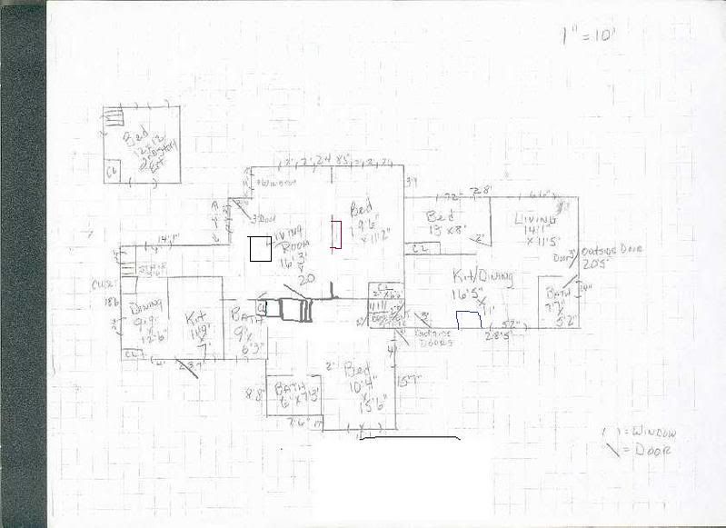

Where are you thinking of putting this stove Eileen and what would be your expectations from it?
I want to put it in the lower level that doesn't get much heat from the apartment (and none from the upper lever, where the PE is), in what is now the master. The master used to be the kitchen, and that's where my Mom had the honking huge porcelain ( i think) over cast coal stove. It was the first stove fired up during the season, and the last to go out in the spring. Eventually move the kitchen back there (not hard, really, plumbing is still there) and make the current kitchen the master.
We've tightened & done some caulking, etc (more to do), and I'm playing with the AC's to check air flow. I did not put a window unit in that room this summer (not using it, why cool it?) and we're running the ceiling fan, and a dehumidifier as needed. It's not unbearably warm down there, but it's definitely consistent with the temps from the winter, only in reverse, if that makes sense to anyone. I figure this past winter was our worst case scenario, so if I'm ready for that we should be OK.
With all this oak coming down around here, just installing a 3rd stove for when it's brutal outside is probably the way to go. It's on a slab, and I'd do a corner install. The 1.1 CF firebox wouldn't cut it, I don't think, but the box in the 12 is the same as the 13, so I don't understand the SF heating ratings difference.
As usual, any input appreciated :-S
Area is at the bottom of layout, middle of house, labeled bedroom 10' 4" X 15' 6".

Da Dixette & I decided last night not to do a corner install, and instead to put it on the long wall between the den ( says bedroom 19' X something), and build a hearth. The heat can come off of the sides and flow to the stairway to the upper level, and flow through the connecting doors to the apartment. I can play musical wood stoves ;-P
