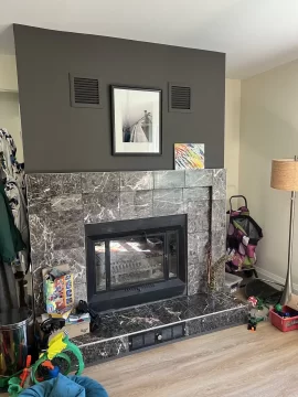

I knew I should have added a photo… The place is a mess right now, though.
The existing fireplace sticks out into the room fully, with no bump out behind at all. I was thinking we’d keep the left wall as a division by the front entry (plus there’s a light switch in it), and remove the front wall and right wall.
Based on what I see outside, the chimney centre is 24” from the left edge of the left wall, so there will need to be a bend in the new flue.
