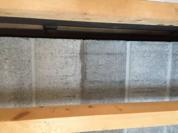

I'm building a house and last fall we had a tile lined brick and block chimney built. It wasn't used at all last year, and we got our woodstock keystone up and running 2 months ago. We were hanging sheetrock upstairs today, and my wife noticed one of the mortar joints looked different from the rest. This looks to me like we have a bad time joint and its leaking smoke into the area around the flue. How concerned should I be, and what would the solution be on what is a really new chimney?

I am far from an expert, but it doesn't look like smoke is leaking to me. It looks like they didn't put enough mortar in at first and after the original stuff was partially dry they added more. Which would explain the different color. Is there any blackening of the wood directly above that point?

No blackening, however if you put your nose to that joint it is clearly a smoke smell. Basically like how the inside of the chimney smells.
No steel liner? Although it does look like a patch I agree with you shouldn't assume anything. Before I went with the insert I had smoke coming out between the mortar of the brick above the lentil and from under the wooden mantle. The installer left a 1" or more gap between the front of the damper assembly and the brick. The mortar was blackened, dry and crumbly. Without a fix it would have gotten worse and worse.
Any way you can inspect it for a gap between the clay tiles? Could burn an intentionally smoky fire, maybe even some newspaper and go look at it. With the lights out and a flashlight you could probably see any smoke. If you have a IR thermo you could check for hot spots. Short of that get a pro.
A liner would definitely be a fix. I too would suspect that there is a gap of some sort on the inside of the chimney. If it truly is just that one area, and the inside of the chimney is fine, then just take a grout knife to it and get out all that old mortar and put in new.
That's the only place it's doing it. I've had a lot of condensation issues so far because we're still under construction. We don't have insulation yet, so I'm constantly heating up a cold chimney. I think I'll have to bring someone in to take a peek down and see if that joint isn't sealed. I could drop a SS liner down, but it's just one year old and I was hoping for a bit longer of a life. Bottom line is I need to feel safe in my own home.

No I don't see or smell smoke coming from the joint. However if you get very close to the joint, there is an odor, which smells like creosote. Seems clear to me there must be a leak in one of the tile joints right around there. I'm just glad we discovered this before we had it fully sheetrocked. Guess I'll be looking at threads on getting a liner down this thing. Bummer considering it's only been used for 2 months. . .
Well if you just had it built call the mason who did it. The stove will probably be happier w/ a liner anyway but if there's a gap you want to know what the story is (i.e. how big and where).
The mason who built the chimney a year ago was an older gentleman who has since fallen ill, so it's a bit out of the question. I'm going to get in touch with a local professional and get it inspected.
honestly I would line it. Better safe then sorry. I would line it with SS even if it was 100% good just for the safety factor.
How much room do you have? enought to put a 6" liner?
Those block are fairly hefty. Chances are good your mason squashed the joint laying that block then wedged it back up into position leaving a mostly empty joint inside. You can see the cracking in the joint which is indicative of what I call a dead joint.
The large difference in color is strange. If he fixed it right away there shouldn't be that much difference. Almost looks like he used straight Portland cement but doing so doesn't make much sense.

I'm thinking your condensation is from burning some wet wood that's creating watery creosote and it found a pocket in that dead empty joint and that is causing the strange discoloration and smell.
I'd recommend that joint be cut out deep with a largish diamond blade and repointed. Cut two opposite sides and point, cut the next two and point. Stucco/parge around the whole joint and call it done. And if your not doing the work watch it be done so some fly by nighter doesn't just score that dead joint and pack another touch on top.
There may be a hole between the flues. That's not uncommon. Shouldn't happen but it does. Some masons lay them dry to begin with, shouldn't but I've seen it done. Most chimneys with some good age on them have no mortar left in those flue joints anyway. It's not optimal but it's not also not the most dangerous thing in the world. The joints on the block work are really your main line of defense against fire.
If that's not good enough you'll have to line it.
As an aside, once it starts getting below twenty degrees in an unheated house and you start a rapid blaze in a chimney. You can split that thing wide open by the sudden heat differential. Go slow when everything is really cold.
