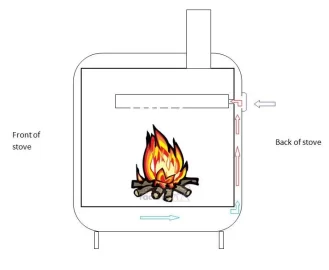

The secondary air inlet has not been shut off by closing this vent. It is now directed to enter via the lower end of the firebox, up the back of the stove and then into the baffle plate, just like on my old stove. My understanding is, is that the secondary air is better pre-heated before it enters the secondary air baffle plate.
I have attached a rough sketch showing what I did. The purple cover at the back is what I fitted and that blocked off the cold air entering the secondary ar baffle. The remaining secondary airflow is illustrated with the blue/red arrows.

Believe it or not, I just looked at the manual, and I couldn't find any reference to that hole. I guess you should contact the mfr. to find out anything. Or, just keep it the way you have it now!

Yes, my manual is also very generic and only gives the basic info and instructions.
I also found that the draught of the stove was not as good as the previous one. I would have to clean the glass more often even though my wood is well seasoned.
I then raised the chimney cap just under an inch and voilla, problem solved. Strange how small things can make such a difference. I now get overnight burns and a very clean secondary burn too.
