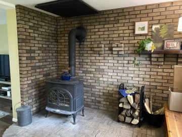

Swapping out a stove can be a quick and easy process if one does their homework first. You'll want a large stove in the the 3 cu ft range. The most important question to start with - what will fit? Does it need to be rear-vented or will top vent work? A picture of the current stove installation will help.

Oh great call about the pic. I didn't even think of that. I'm not sure about the rear or top vented question, but I think I have a decent amount of space to work with.

Really just something that will work w/ the space (see pic in other post). I'm stuck with that 70s style brick on the hearth, so nothing that clashes too much with that.
If you like the cast iron look, then the Jotul F55 or the PE Alderlea T6 will work there.

If you want to brighten the brick, just dilute some white latex paint with 50% water and white wash it. We had that in our old house and it looked great. The darker spots of brick will show through a bit . You can find pics that people did online.
Did you want a top loading stove like the F-12 is? If not, and you like Jotul the F55 Carrabassett will be a fabulous replacement, a bit more heat and easssssssy to operate too. Nice setup you have too, it will be an easy changeout.
