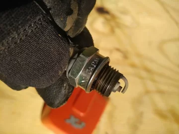

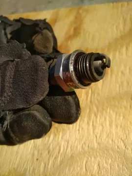

Pull the spark plug and go from there, if it has metals particles on it or the ground has been smashed something internal to the engine failed. If nothing on the spark plug look into the cylinder to see what you can see. Does the engine turn over at all?
Good call. I should have done that before my original post.

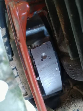

Just pulled the plug and it looks fine, the ground is not bashed and no metal particles that I can see. I also looked inside and I don't see any metal particles on top of the piston.

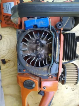

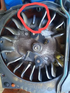

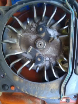

Thanks for the suggestions everyone. I did some investigating and here's what I found.
Took the recoil off and immediately something didn't look right with the flywheel
[Hearth.com] I think my 372XPW is toast

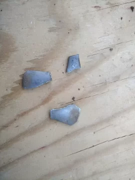

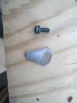

A screw had come loose from somewhere under the cover and found it's way over to the flywheel. That's what the noises were, the screw bouncing around the flywheel like a pinball machine. Broke one of the fins off so both the screw and broken fin were bouncing around in there making all that racket until the screw finally jammed the flywheel. That's why I couldn't turn it over. Took the screw and broken fin out of there and sure enough the engine turned over. A few nicks and dings in the flywheel but I suppose it could have been worse.

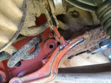

Next order of business. Figure out where that screw came from. After a little looking, I found it on the top under the carb.

Put everything back together and fired it up and ran it a bit. Within about 30 seconds I heard more clanking noises and shut it off right away. A couple more fins had broken off the flywheel. Guess it's time for a new flywheel. But again, it could have been worse.
