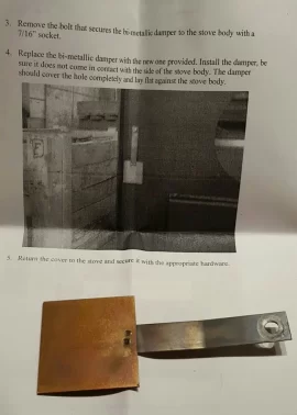

It's normal for the IS, but if the noise annoys you they'll send you something to stop it. There's nothing wrong with the stove, I just forget what the cause is
IIRC it's the bi metallic piece on the back that supplies the cat air??

Mine has never made that noise before. The sound of the cat supply strip warming up was more of a clanging alarm clock sound. When us early production customers got our first stoves we flagged that right away. Woodstock sent us a strip with a piece of felt on it. That was as early as November of 2014. I can't imagine they would still have the old style in production.
Here is a picture of the early style bimetallic strip.
