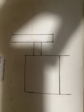

My son is considering a Ideal Steel for his home he just purchased as he wants a rear vent for his situation...he asked me if you can put a clean out T exiting the rear of this stove? I did not have a answer for him...has anyone done this? Edit...he wants the T inside the home as soon as it exits the stove..
Yes
Let me explain further...he wants the T inside the house coming directly off of the stove inside the stove room as the stove will be centrally located and he does not want to have to disassemble pipe to clean it..

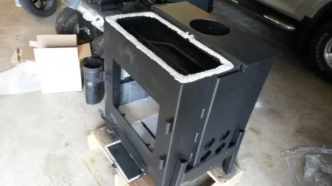

I've been reading up on the IS some more, because, well, it's a cool stove. Here is a photo of the stove top lifted up and off. Easy access to where the brushed debris will pile. Also note that you can shove the brush right into the stove without hitting anything sensitive.
