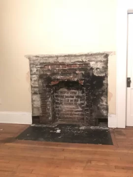

Hey guys I have been piecing this plan together little by little and it seems every time I have a better and safer plan I run into a snag.
I have a sweet flex liner kit 6” coming next week which I feel comfortable installing.
I have not nailed down a stove yet. Mainly because I keep wrestling with my firebox, hearth, mantle, combustibles, etc.
I know I don’t want to build up a hearth, and I know I want a free standing stove. I would love to safely utilize this 35.5” hearth (back of firebox to edge of hearth)
One thing that seems to be a common issue with my setup is stove pipe length. Is there a requirement for inches of stove pipe before it ties into flex?
Another thing that keeps coming up is clearance to non combustibles on either side so stove can radiate the heat. The hi flame small stoves say they recommend 6” on either side, 12” on the top, and 3” in the back.

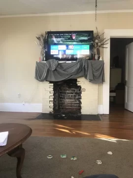

Here is the latest it’s really a blank canvas now.
Stove recommendations with large viewing glass. I do like to clean look that a lot of the European styles have.
6” diameter flex line coming this week

How wide is that? A lot of rear vent stoves would fit nicely in there, any of the woodstocks, if you have the room, Jotul's also rear vent. I was thinking the newer Woodstock steel stove since you have 1300 sf.
Need full dimensions including depth. Will the lintel be restored and if so at what height?
Rough opening about 25” wide
Lintel will be at 35” high
Depth of 8.5”
Hearth then extends out 27”
The width of the stove will be an important factor as will a stove with the flue connection close to the back of the stove. Some flue connections on some stoves are a bit inboard and then if the stove has a blower that adds more depth at the rear of the stove. Is there any style stove in particular that you are fond of?
I like the Englander 17vl
Just a little worried about the sharp turn I’d have to make to go up the chimney
The 17VL has a small firebox and it's a bit tall for that space. You'll want to give yourself sufficient wiggle room for running to the liner to the flue connection. How large an area will the stove be heating?
This is a very shallow fireplace.The 17VL depth does help here. There are some cast iron stove of similar capacity and depth like the Jotul F3CB that are shorter.
What does it mean when you quote someone? I’m new to this lol. Also do you think I should go after a top vent or rear?
Nothing. Quoting just makes it clearer about what one is responding to.
Definitely top vent for this location.
How well is your house insulated, I suppose it has to be decently insulated for high summer temps when running the ac?
1300sq, the 17vl will work since your located pretty far south on the north side of S. Carolina, the main issue will be fire box size, you will have to use smaller splits and you will only get about a max 3-5 hr burn time.
The main issue like BG mentioned is how are you planning on tying in the stove, the 17vl is about 32" in height and fairly shallow, so you may need to set it as far into the fire box of your fire place as you can and you will need to have a flex liner mount to a 45deg stainless steel adapter to get the right bend, but even then that might be cutting it close. but the three nice things are, you can automatically keep your hearth as is because you will have your 18" in front of the loading door, the stove is ember protection only and it is jacketed so its more conductive than radiant, with using the blower your wont have an issue throwing heat into the room.
With the liner, you will want to have it pre-insulated, unless you can guarantee that the chimney is built to spec with 2" clearances from anything combustible (air space around brick masonry, look in the attic) unless you have 8' minimum solid masonry (highly unlikely)
