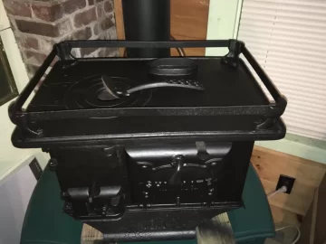

I have a Shipmate model 1011, and want to paint the exterior to give it protection while in storage (and for sale). Some of the existing paint appears to be of a harder, glossier nature than your typical matte stove black. Any ideas?

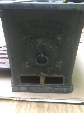

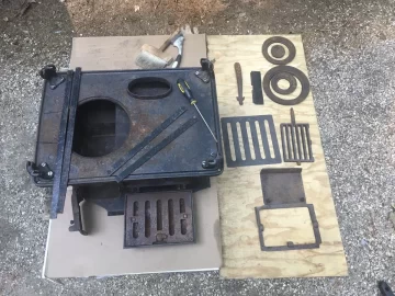

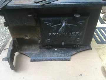

Might be Stove Rite gloss black. You'll want to steel wool or power wire brush the old paint to give it a bit of tooth for the new paint to bond to.

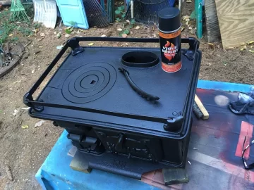

I called makers of stove brite. They felt the original was a glossy baked on enamel. Recommended their semi gloss spray. Supposed to be heated for a few hours at about 450 to achieve best bond.
Was able to track down a can of semi gloss stove bright @$24.
