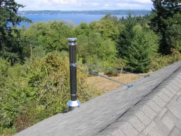

I thought DuraVent class A was all stainless pipe too. This is our install. Where did you hear it was galvanized? The flashing is aluminum I believe, but the pipe is stainless.
