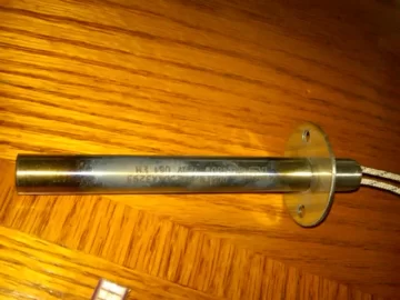

The enviro ignitor is not just the element
a mounting flang is welded tube that will only fit a few model of Enviro
  • [Hearth.com] Ignitor - AfterMarket for Enviro specs
Stove Doc - Thank youuu!!! OK! That saves me a lot of needless work pulling the insert out. Guess I'll just light manually till an ignitor comes in. In a worst case, i'd see if I could rig up a replacement $25.00 job with some kind of attachment.
