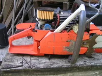

I give all my saws a complete cleaning with compressed air after each cutting session,whether its 30 minutes or 8 hrs.Takes 5 minutes tops & rewards me with more power & effientcy next use. [Hearth.com] I'm an idiot, or how not to take care of your saw...

I give all my saws a complete cleaning with compressed air after each cutting session,whether its 30 minutes or 8 hrs.Takes 5 minutes tops & rewards me with more power & effientcy next use.View attachment 63726
