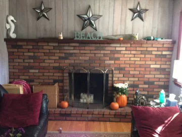

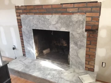

OK - after almost a one year renovation in our home, I have gotten rid of a wall to wall hearth and façade from our home's existing fireplace. The outside of the chimney is in my attached garage. I have a one story L-ranch (1800-1900 sq ft) built in the late 1960's, where a few walls have been removed to create the open floor concept that seems to be all the rage. We aren't done yet, but we are getting there. Baby steps, I guess. The new surround and hearth has been installed and the mantel is currently being made. I can't tell you how many hours I have spent trying to design everything to code and our style with the intent of installing a wood burning insert.
Well, finally, this Friday 1/3/14, a Hearthstone Clydesdale in matte black is going to be installed in our fire box. We were originally going to get the Fireplace X 33 inch flush mount but at the last minute my wife fell in love with the looks of the Clydesdale. I think we made a good choice considering everything I have found and read on the internet.
February 2013 I had three monster oak trees, one huge maple and two cherry trees cut down and I kept 90% of the wood, borrowed a friends Cub Cadet splitter (25 ton I think...awesome machine) and split and stacked it all by April 1st. I had tarps covering most of the tops of the rows of wood. My intent is to start out supplementing our heat to cut down on the expensive fuel oil consumption but ultimately I would like to heat with the insert as close to full time as possible. So, I think that I have at least two years worth of wood split (but that won't stop me from scrounging around as often as possible).
Please feel free to let me know what you think and any useful tips that could help a rookie out. I will post pics of the current state of the project and after install pics as soon as I get them and can figure out how to post them!!

The snow storm that hit us last night postponed the install of the insert. :( Installation has been rescheduled for next Saturday. Oh well, can't have a guy on a roof covered with snow sending down the liner!
