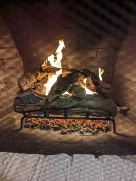

we bought a house with an old open-vent wood fireplace in which a gas heater was installed. How can I determine whether I have a ventless or vented gas heater?
Assuming it needs to be vented, how can I improve its efficiency without investing a huge sum and without affecting its look too much? The current system looks nice but I assume most of the heat goes up the chimney.

Technically, you have a gas log set, not a gas fireplace. It is very inefficient, about - 10 on a scale of 1 - 100. It’s equivalent to having a campfire in your living room. It will give warmth, not heat. There is not an inexpensive means of improving the efficiency. Ceramic glass doors are costly, as is replacing it with a DV gas insert. As far as determining whether it’s vented or vent free, we need to better see the pilot assembly.

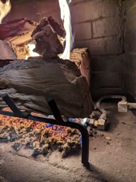

The gas logs I have do not have a pilot, I manually light them with a lighter. Anything else I can show you?
Show me the pilot assembly & the gas valve
