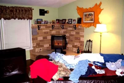

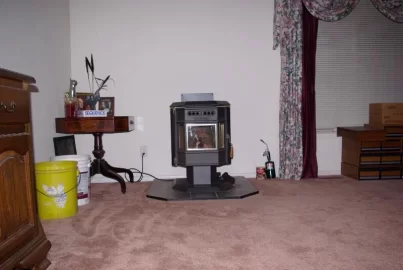

WE have two used Whitfields
Paid $200 each off craigs list
All told I have about $600 in the one with a complete makeover that included a raised hearth, wall treatment, vent system and a mantle too.
The other one was complete and cost me very little over the $200, just a thimble and my labor.
Good deals out there, just shop a bit
My feelings are, age means little and condition is everything.
Just stick with a make and model that parts are still available, even if its aftermarket.
Here are a couple pix
Large whit with hearth and mantle
Little whit with floor pad and short through the wall.
Best
Snowy
